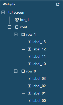

With respect to identifying child objects within the container, the simplest way to do so in GUI Guider would be to pay attention to the order that the objects are arranged on the Widgets menu. This menu arranges children by descending order. Therefore, for this arrangement of the labels inside of the container:
  • Label_1 is child 0
  • Label_2 is child 1
  • Label_3 is child 2
  • Label_4 is child 3
If the number of labels inside a container is too large, you could also nest containers inside of the main container, which would allow referencing for each label to be similar to a grid. The first layer of child object would be the row, while the second layer of child objects would be the column. For example:
EdwinHz_2-1713314937134.pngEdwinHz_2-1713314937134.pngEdwinHz_3-1713314968641.pngEdwinHz_3-1713314968641.png
In this case, child 0 of the child 0 of the main container would be label "x0y0", and child 2 of child 1 of the main container would be label "x2y1".
I hope this helps!

4,051 Views
EdwinHz
Hi @abs_setian,
Perhaps the Container widget might just be what you are looking for. This widget is a simple object that is used to encapsulate and group several other widgets of any time inside of it and maintain them organized with a specific layout. It could contain an array of buttons, labels, images, etc. It can also contain a mixed combination of widgets. Any widgets inside of the container will be considered to be grouped and can be moved or transformed in conjunction.
If what you need is specifically an array of buttons, then the widget to use would be a Button Matrix. It is quite similar to the container, but optimized for button usage, and it consumes less memory than a container with buttons.
With respect to the automatically generated files, GUI Guider will replace any modifications you do to the files that are not custom files. That said, I would recommend you create the GUI using GUI Guider, and then do the tweaks and extra modifications of the files on MCUXpresso or other supported toolchains like IAR or Keil MDK. The process to import a project and continue development on an IDE is described on chapter "5 Development" of the GUI Guider User Guide.
I hope this helps!
BR,
Edwin.

4,018 Views
EdwinHz
Hi @abs_setian,
I'm not quite sure I understand the reasoning behind a hidden 3rd row, but I believe the situation you are presenting is about positioning each row relative to the previous row or to the container as a whole. If this is the case, you could use percentage values to align each label to a relative position of the container rather than a specific coordinate, or the lv_obj_align_to() function to align an object relative to another object. Both of these possibilities are described on the following site: Positions, sizes, and layouts — LVGL documentation
I hope this helps!
BR,
Edwin.
3,934 Views
abs_setian
Oh!!! I've got it!!!!
Then, I can access each object like this
: row_1->child[0].[1],[2] ... and so on.
Thank you!!!
I can keep develop.
