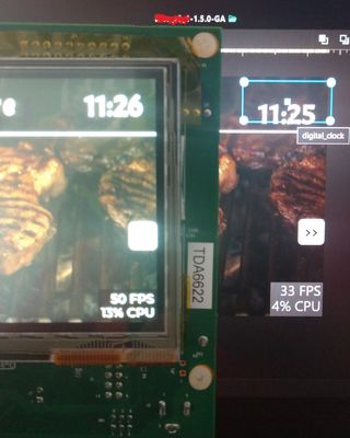

I found a problem with the positioning of the widget, which is partly related to the size not so much of the displayed time, but the size of the widget itself.
Here are two examples: 
1. The clock on the device is displayed ok, but in the GUI Guider the displayed clock is shifted (theoretically, the blue frame from the selection is in the correct place).
2. Example in the other direction, in GG it's ok, the problem with the shift is on the device.
Interestingly, by reducing the size of the widget (I don't change the font size or the font itself), it looks like this in GG, but on the device it displays correctly in the middle of the screen (Picture below).
Configuration information:
Guider GUI version 1.5.0-GA,
built-in fonts (acme-regular selected),
target device (temporarily) Devboard RT1060-EVK

We release new version of Gui Guider (GUI Guider v1.5.1 RC2 )  that we corrected several errors, I suggest that you import your project to this new program to check if this type of error has been corrected.
