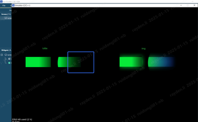

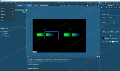

Figure 1 shows the Lottie raw graph before compilation, from left to right, with a gradient from green to light blue.
On the right side of Figure 1 is an img photo, which is used as a comparison.
Figure 2 is compiled, running only from left to right, all green, no light blue, why?

I was able to replicate this issue, and it seems like this issue is inherited from Lottie itself, not GUI Guider. At least, this is what I've gathered from the following links, all of which describe an issue when using transparency and gradient at once:
Gradient and transparency · Issue #833 · airbnb/lottie-android
issues with gradient and transparency · Issue #1162 · airbnb/lottie-web
Gradient and transparency animation issue · Issue #2091 · airbnb/lottie-android
I recommend you post this issue on the airbnb GitHub and let them know about this Lottie related issue.

The GUI Guider version Gui Guider1.8.1-GA. As attached ‘Input_Left.zip’, it is a Lottie raw graph.
This issue comes up when I run the GUI Guider emulator. The compiled program has not been ported to the MCU.
