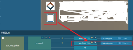

Hi:
Recently, I encountered a problem in the process of using:
I created a label, and then triggered the event to enlarge or shrink another label, and then simulate was not successful. When the label was pressed, the other label did not respond.
Four interface functions are used: lv_obj_set_style_transform_pivot_x(item_array_1a[i].item_obj_icon, 50, LV_PART_MAIN);
lv_obj_set_style_transform_pivot_y(item_array_1a[i].item_obj_icon, 50, LV_PART_MAIN);
lv_obj_set_style_transform_width(item_array_1a[i].item_obj_icon, 512, LV_PART_MAIN);
lv_obj_set_style_transform_height(item_array_1a[i].item_obj_icon, 128, LV_PART_MAIN);
so, why labels cannot be scaled up and down? Is the LVGL interface used incorrectly?

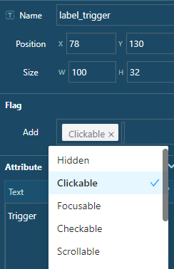

Could you please check whether the LV_OBJ_FLAG_CLICKABLE flag has been added to your trigger label widget? By default, label widgets do not have this flag enabled, so they won’t respond to click events unless it’s explicitly set.
You can add the flag in the widget’s Flags section like this:
Hope this helps! Feel free to share more details or let us know if you need further assistance.

I added flag: add clickable according to your screenshot, but there was still no reaction. For other keys, I set the trigger event to change the color of the background image of the label when clicked. This can be achieved, but the zoom and zoom note interface function has not been able to work

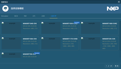

Yeah, what I'm trying to do is I'm going to make label_b scale when I click on label_a. In addition, why use V8.3.10 version is because we use the development board of your company MIMXRT1170-EVK, LVGL V9.2.1 version does not have the corresponding device template, but V8.3.10 exists. Our company also hopes to use the latest version of LVGL version. Is it possible to use the device template without MIMXRT1170-EVK development board now?
