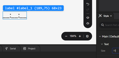

Getting a bug where the displayed font size is much smaller than the true font size for size 20.
Size 21:
Size 20:
Size 19:
It looks to be using the size 14 font in place of the size 20.

Hi @c_nebe
I tested it on my end.
Harry_Zhang_0-1788257251619.pngHarry_Zhang_1-1788257276889.pngHarry_Zhang_2-1788257288278.png
I haven't reproduced the issue you mentioned.
