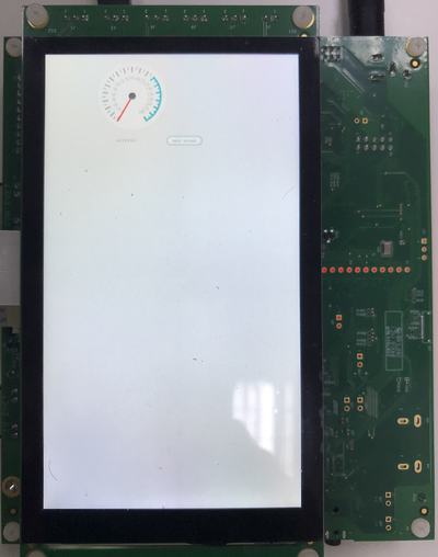

Now, I want to do interface design on RT1176 with GUI_guider .When i used 'printdemo' on RT1176 , the screen displayed the different situation .I tried to change the corresponding length and width, but only the upper 1 / 3 of the screen is white and the lower area is black.I use the official development board and the corresponding screen.What should I do to make the instance light up on the whole screen?DINGTALK_IM_3419766419.JPG

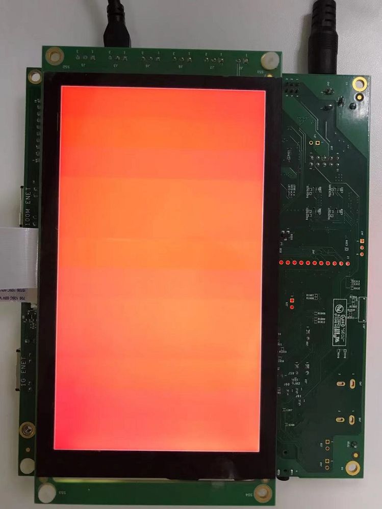

Hello chenjun,
According to your inputs, the display issue occurs when you port the GUI Guider(v1.2.0) app to MCU SDK v2.9.0 example project. please change to use the MCU SDK v2.10.0 which the new GUI Guider is compatible with.

LVGL (v7.10.1) in GUI Guider v1.2.0 only supports portrait mode on 720x1280 display of i.MX RT1176. When the width of APP is greater than the height, the APP will be displayed in top partial area of the display. In order to support landscape mode, the MCU needs to rotate the frames either by software or by PXP or GPU.
The rotation function by CPU is implemented in LVGL v7.11.0+, GUI Guider v1.3.0 in Jan/2022 will support LVGL v8.x, the landscape mode will be supported in the release.

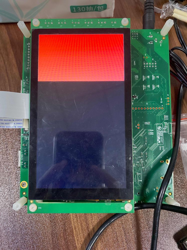

chenjun
When setting, I set 720 * 1280 instead of the width and height of the screen.
16,493 Views
chenjun
Whether I use the routines in the SDK or the GUI_ The guide drew it by himself. The effect produced by operation is that only the upper half is displayed.Is it necessary to set a corresponding parameter?

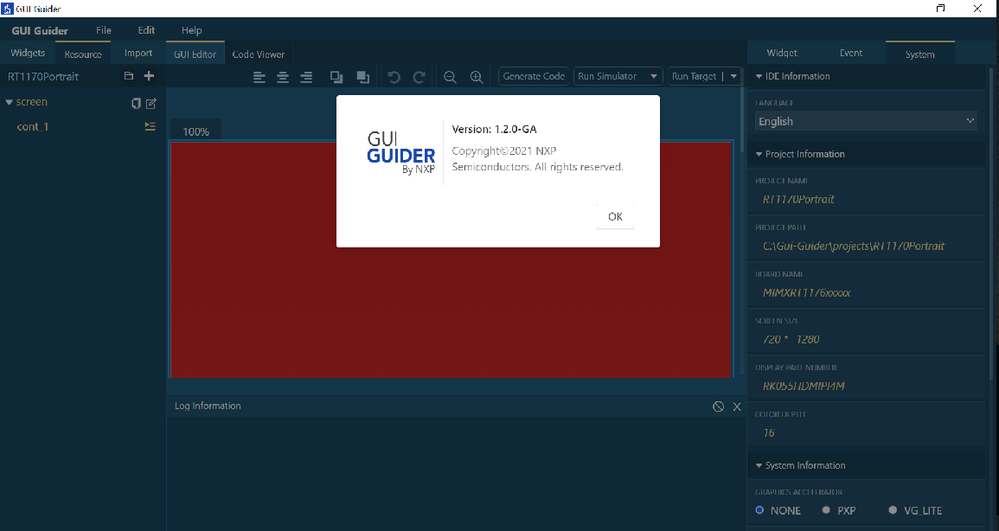

May I know which GUI Guider version is used by you? Can you please try GUI Guider v1.2.0 which includes a improvement of portrait mode (720x1280) display. The following is the step and full screen display effect.
Zhenhua

chenjun
I used GUI_GUIDER v1.2.0DINGTALK_IM_3845176407.JPG.JPGE03CFE91-053E-4937-8F03-CEB3C277A44B.png

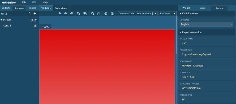

zhenhualuo
Hi chenjun,
Pease try to use GUI Guider v1.2.0 to deploy attached project which includes a full screen container of red color and check if it works on your side, if it works, you can check what's the difference of the project as yours. You can also share your project with us, we can take a look why your project is partial screen display. The following is the snapshot of my project.
Zhenhua

chenjun
hi zhenhualuo,
First of all, thank you very much for solving this problem. The problem is that the version of MCU Xpress IDE is wrong; I have another question,  How to import the GUI_guide program into the MCU Xpress IDE for secondary development.
