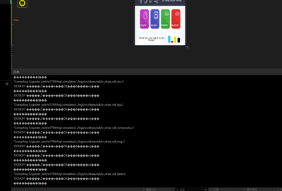

I run gui guider 1.9.1 on Windows 11. When clicking on the run simulator icon (green play button) my output gets littered with lines that always read the same:
'doskey' is not recognized as an internal or external command, operable program or batch file.
This has no impact on successful compilation, but it is annoying since there are so many extra lines in the output.
I did some research about the error and it is normally related to doskey location (C:\Windows\system32) not being on the system path. however, on my system it is on the system path, i checked.
The other issue could be that doskey needs to be run with admin rights, but starting gui guider with admin rights also does not solve the problem.
Note that normal compilation (Ctrl+G) does not show this problem, just compile and run in simulator shows these annoying doskey lines.
Please help. should i copy doskey.exe directly to the guiguider directory, but where to put it there exactly?
I have not had this problem in older versions of gui guider but must add that i have just switched to a new pc running windows 11, the older versions of gui guider i used always ran on windows 10 without a problem. so maybe it is a windows 11 issue.

Hi @josefhaydn,
It is likely that something went wrong during the installation of GUI Guider that caused path issues with doskey. I'd recommend you uninstall and reinstall GUI Guider again, this time making sure you install will full administrator access.

josefhaydn
Hello, I have solved the issue with Google Gemini by accident.
It turned out that conda had messed with the standard Windows command processor, it wrote its own string into the registry. Here my lengthy discussion with Gemini.
I have only vague memory but in the end changing the registry key mentioned below to the standard windows command processor solved it.

aha, i see that miniforge has messed with that value. how should i change it so that minforge keeps working but also gui guider works with doskey?
Current Entry:
if exist "C:\ProgramData\miniforge3\condabin\conda_hook.bat" "C:\ProgramData\miniforge3\condabin\conda_hook.bat"
Show thinking
Aha! Thank you, that is the crucial piece of information. This is a very common setup for developers using Conda or its variants like Miniforge.
Your AutoRun key isn't calling doskey directly. It's calling Conda's environment setup script (conda_hook.bat). The "DOSKEY not found" error is happening because that conda_hook.bat script (or another script it calls) is the one trying to run doskey.
The root cause is exactly the same as we diagnosed: The hook script runs fine in your normal terminal, but fails in GUI Guider's limited-PATH environment because it can't find doskey.exe.
You must not delete or simply replace this registry entry, as that will break the functionality of your Conda/Miniforge terminal environments.
