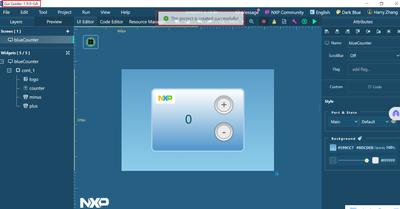

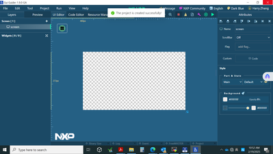

8,165件の閲覧回数
Harry_Zhang
Hi @Loic128
I tested the GUI GUider-1.9.0.
I can successfully create a project.
Please refer to the image.
Harry
