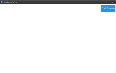

I have created 2 pages and I can switch from one to another. When I switch the page and then turn back to the same page, this button we created becomes unvisible. How can I make it visible forever on that page ?
In fact I want to know how to manipulate generated files with custom codes. For example there is a screen and there is a button on that screen built with Gui Guider, how can I change this button's spesifications with custom area files ?
frozen_0-1691068552075.pngfrozen_0-1691068552075.pngfrozen_1-1691068573702.pngfrozen_1-1691068573702.png

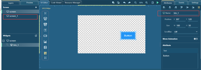

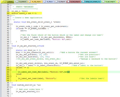

I made some modifications to the code in "custom.c/custom.h", and made the button always on the display by reloading the button object in the new interface. The specific method is as follows:

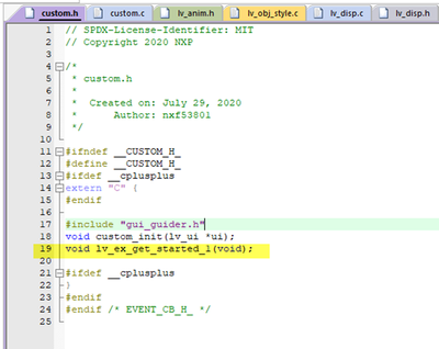

1. Modify the code in "custom.c/custom.h".
2. Add a button control named "btn_1". Add the second page named "screen_1".

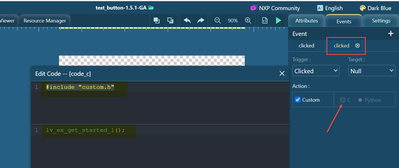

3. Add two events to btn_1, namely page switching event and custom event.
The time in the page switch event is set to 0.
Add header files #include "custom.h" and" lv_ex_get_started_1()" to the custom event "Edit Code"

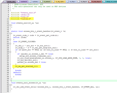

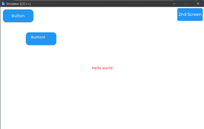

4. Generate the code again, you can see the following program in "events_init.c", and then view the effect in the emulator.
