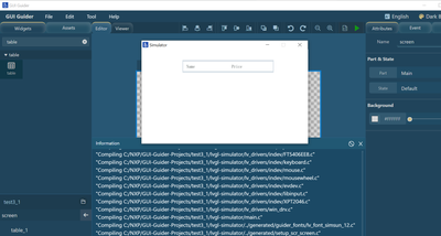

Hello @PragmaLab
Which version do you used? I test on my side, I haven't find the error you mentioned:
