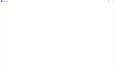

username_not_found
I have just installed GUI Guider V1.4.0 for the first time. GUI Guider shows a blank screen on launch. I am using Windows 11, 64 bit. I cannot interact with the GUI Guider or close it, except by killing it via the task manager. Is there any way I can fix this, or troubleshoot what is happening?

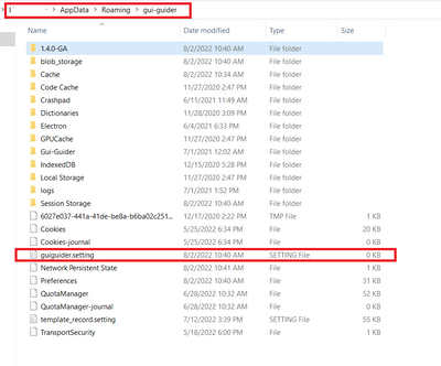

6,541 Views
LiubinGong
   If it is the first time installing a new system, I think you need to add an empty file named "guiguider.setting" on "%AppData%/gui-guider/guiguider.setting". BTW, win11 is not verified.

6,522 Views
username_not_found
Unfortunately adding the file "guiguider.setting" had no effect. The program still shows a blank interface, even after restarting my PC.
I have also tried downloading GUI guider 1.4.0 on a different PC with Windows 10, and the same thing happens, I only see a blank interface.

6,511 Views
zhenhualuo
Please change the content of "%AppData%\AppData\Roaming\gui-guider\1.4.0-GA\guiguider.setting" to the following and try again. "%AppData%/gui-guider/guiguider.setting" can be removed. Please follow the user's guide to install JAVA on host.
        "workspace": "C:\\NXP\\GUI-Guider-Projects",
        "historyProjectList": []
