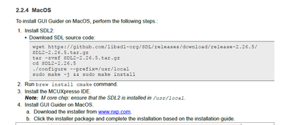

Hello! I'm using version 1.6.1(GUI GUIDER) on a MAC with an M1 chip as the OS(Ver 14.1.1).
When I open the default "kitchen" or "aircon" projects and simulate without editing anything,
a "Make Run Error" occurs.
Please tell me how to address this.
Do I need to configure anything? I just want to try GUI GUIDER, so I don't have EVK connected.

SDL2 was not installed locally! Simulation is now available. Thank you for your assistance!

Error codes are as follows
Compiling /Users/GUI-Guider-Projects/coffee/lvgl-simulator/lv_drivers/display/UC1610.c
Compiling /Users/GUI-Guider-Projects/coffee/lvgl-simulator/lv_drivers/display/SHARP_MIP.c
/UsersGUI-Guider-Projects/coffee/lvgl-simulator/lv_drivers/display/monitor.c:20:10: fatal error: 'SDL2/SDL.h' file not found
#include MONITOR_SDL_INCLUDE_PATH
/Users/GUI-Guider-Projects/coffee/lvgl-simulator/lv_drv_conf.h:102:39: note: expanded from macro 'MONITOR_SDL_INCLUDE_PATH'
# define MONITOR_SDL_INCLUDE_PATH
:63:1: note: expanded from here
make: *** [build/object/monitor.o] Error 1
make: *** Waiting for unfinished jobs....

LiubinGong
Hi @OIHY098011
     Please try other applications to see if they work properly. If it is the same problem, Please check whether the installation dependencies in the document are installed correctly.

OIHY098011
Thanks for your comment.
I have tried following the instructions, but unfortunately I have not been able to solve the problem.
I have downloaded and installed SDL2 from Git. I have confirmed that it is installed without fail.
I have also installed MCU Expresso.
However, whenever I run the simulation, I get a make-run error.

LiubinGong
Hello @OIHY098011
   Can you please provide more details?
   Please go to "{projectpath}/lvgl-simulator" and run "make -r -j8 & make run"
