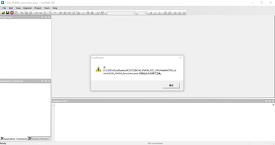

open the file S32K_PMSM_Sensorless.pmp error
4,841 Views
Lilac
when I double click S32k_PMSM_Sensorless.pmp, I can't open the FreeMaster.
It will show like this:
which means:The file handle associated with ...... is incorrect.
4,832 Views
ArchieLuo
使用3.0版本的FreeMaster打开就可以了。这个应该是新版本创建的(或者是用新版本打开过再保存的),旧版本的FreeMaster打开不了。
4,812 Views
MichalH
NXP Apps Support
NXP Apps Support
most probably you have an older version installed and it fails to open a project saved in later version. Updating to the latest (3.1.3) should resolve the issue.
Michal
4,833 Views
ArchieLuo
4,810 Views
Lilac
谢谢啦!已解决
