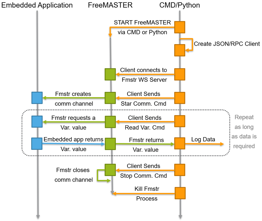

Assuming your application flow looks like the one in the picture bellow:
it's up to you when the data logging should be stopped (it is basically controlled by your script). If you want to Stop FreeMASTER just kill the process: taskkill /IM pcmaster.exe (assuming you have only one instance of Fmstr running on the PC, otherwise you'd need to obtain the PID and use it with taskkill command).
Note: the same can be achieved with Python as well (subprocess.Popen/os.kill), or any other external application.
Btw, have you heard about FreeMASTER Lite (it's a light weight NodeJS wrapped build on top of the FreeMASTER communication library). It has no UI, and you could run it in the background without the need to each time start/stop the process (the flow would be just as above, but without first and last nodes).

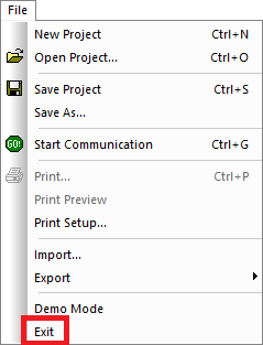

What 'Exit' active-x command does?
Vinod
13,656 Views
iulian_stan
It instructs the FreeMASTER application to quit. Equivalent to pressing the Exit option in File menu.

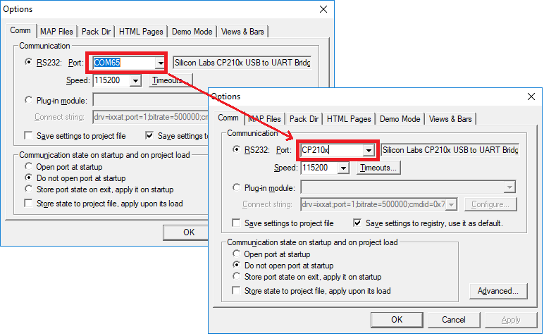

Can you please tell- How can I fix the PC's comm port used by freeMaster application? connected to kinetics MKE14Z based micro.
During testing of units we find that freeMaster comm port number changes from unit to unit.
Or else Is there a script command available in active-x to define or set comm port in freeMaster - basically same as we do manually by going into Project ---> options. I can read the comm port number using dos batch command & then can set the port number in freeMaster if a command is available.
I could not find StartComm commands in active-x which is given in the manual.
Vinod
13,656 Views
MichalH
NXP Apps Support
NXP Apps Support
Dear Vinod,
the USB/COM port numbers are assigned by Windows system. FreeMASTER cannot change the number. However, for the desktop FreeMASTER application, there is one trick that could help you.
You do not need to specify the COM port by exact number like COM65 (see the picture below). You can use any word or sub-string from the port's description text, that is displayed next to the port number in FreeMASTER Options dialog. This text is always the same for the same kind of port, even if number changes when you plug-in a different board (of the same kind). In order to make the identification unique, you just need to pick a word from the description which is not contained in other ports' descriptions.
