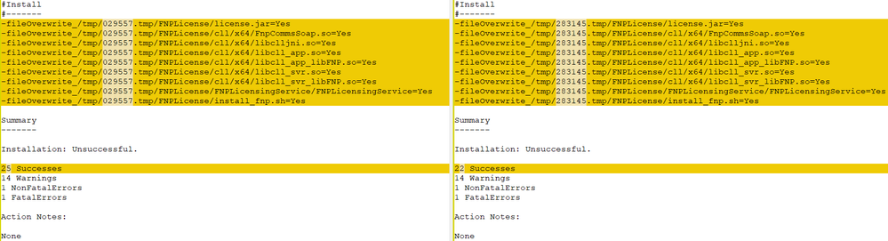

yjy
__________________________________________________________________________
Tue Aug 27 07:52:43 CST 2024
Free Memory: 18322 kB
Total Memory: 39936 kB
java.class.path:
/tmp/install.dir.88991/InstallerData
/tmp/install.dir.88991/InstallerData/installer.zip
ZGUtil.CLASS_PATH:
sun.boot.class.path:
<none specified>
java.ext.dirs:
<none specified>
java.version == 22.0.2 (Java 2+)
java.vm.name == OpenJDK 64-Bit Server VM
java.vm.vendor == Arch Linux
java.vm.version == 22.0.2+9
java.vm.specification.name == Java Virtual Machine Specification
java.vm.specification.vendor == Oracle Corporation
java.vm.specification.version == 22
java.specification.name == Java Platform API Specification
java.specification.vendor == Oracle Corporation
java.specification.version == 22
java.vendor == Arch Linux
java.vendor.url == https://openjdk.org/
java.class.version == 66.0
java.library.path == /usr/java/packages/lib:/usr/lib64:/lib64:/lib:/usr/lib
java.compiler == null
java.home == /usr/lib/jvm/java-22-openjdk
java.io.tmpdir == /tmp
os.name == Linux
os.arch == amd64
os.version == 6.10.6-zen1-1-zen
path.separator == :
file.separator == /
file.encoding == UTF-8
user.name == yjy
user.home == /home/yjy
user.dir == /tmp/install.dir.88991
user.language == en
user.region == null
Installed Feature(s) FMSTR Lite, FMSTR NM of FreeMASTER Lite 1.3.0
Install Begin: AUGUST 27, 2024 7:51:42 PM CST
Install End: AUGUST 27, 2024 7:52:39 PM CST
Installed by InstallAnywhere 20.0 Premier Build 6336
User Interactions
#Choose Product Features
CHOSEN_FEATURE_LIST=FMSTR Lite,FMSTR NM
CHOSEN_INSTALL_FEATURE_LIST=FMSTR Lite,FMSTR NM
CHOSEN_INSTALL_SET=FL
#Choose Install Folder
USER_INSTALL_DIR=/home/yjy/NXP/FreeMASTER Lite 1.3.0
#Choose Link Folder
USER_SHORTCUTS=/home/yjy/Desktop/FreeMASTER Lite 1.3.0
#Install
-fileOverwrite_/tmp/029557.tmp/FNPLicense/license.jar=Yes
-fileOverwrite_/tmp/029557.tmp/FNPLicense/cll/x64/FnpCommsSoap.so=Yes
-fileOverwrite_/tmp/029557.tmp/FNPLicense/cll/x64/libclljni.so=Yes
-fileOverwrite_/tmp/029557.tmp/FNPLicense/cll/x64/libcll_app.so=Yes
-fileOverwrite_/tmp/029557.tmp/FNPLicense/cll/x64/libcll_app_libFNP.so=Yes
-fileOverwrite_/tmp/029557.tmp/FNPLicense/cll/x64/libcll_svr.so=Yes
-fileOverwrite_/tmp/029557.tmp/FNPLicense/cll/x64/libcll_svr_libFNP.so=Yes
-fileOverwrite_/tmp/029557.tmp/FNPLicense/FNPLicensingService/FNPLicensingService=Yes
-fileOverwrite_/tmp/029557.tmp/FNPLicense/install_fnp.sh=Yes
Summary
Installation: Unsuccessful.
25 Successes
14 Warnings
1 NonFatalErrors
1 FatalErrors
Action Notes:
None

23 Replies
10,515 Views
iulian_stan
Hi @yjy
The only error I can see your logs is "Additional Notes: ERROR - Error writing LaunchAnywhere components (Access Denied)". Did you try running the installer with elevated rights ?
Another thing I would check is the file integrity, could you re-download the installer ?

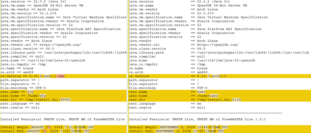

10,499 Views
yjy
yeah,I have tried to run 'chmod +x ./freemaster.bin' before installing, and i have tried 'sudo chmod 777 ./freemaster,bin' ,but it also doesn't work.and the terminal noted that ./FMASTERL13(2).bin: line 3652: hostname: command not found when I tried to install
10,480 Views
iulian_stan
Does the installer prompt you to introduce your user password for sudo ? (Even if your user is in the sudo group the installer may need to execute internal commands as root).
Additional thing to try is to set the following environment variable before running the installer:
export LAX_DEBUG=true

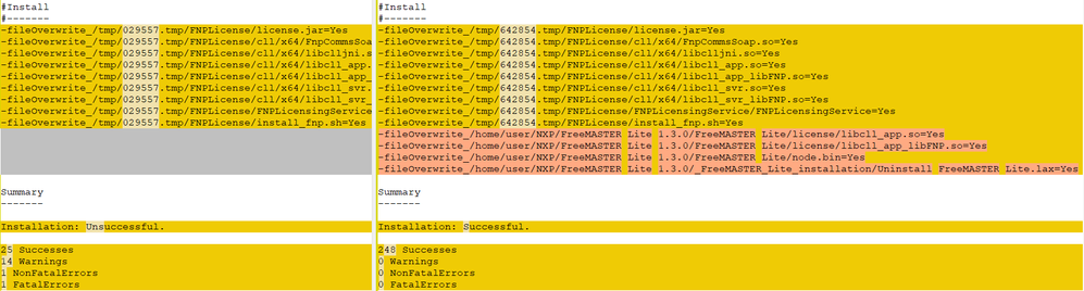

10,406 Views
iulian_stan
Do you mean that if you uncheck "FreeMASTER Lite" option the installation succeeds ?
Could you share the installation log file ?
10,384 Views
yjy
there are freemaster contents
10,384 Views
yjy
10,386 Views
yjy
yeah , I unchecked the lite and it didn't roll back, however I can't see any executable files .
When I was installing, I referred that ''https://www.ibm.com/support/pages/could-not-find-or-load-main-class-comzeroglaxlax-when-trying-insta...'' and it worked.

iulian_stan
From the old logs I noticed that "LaunchAnyWhere" step comes around the license validation. Does your installation reaches the license validation step ? Does a popup window show up after you press the Install button ?
Also, what Linux distribution are you using ? (could be a compatibility issue)
10,322 Views
iulian_stan
I asked about license validation because I saw a similar issue in a thread from another community space.
10,236 Views
yjy
firstly, I don't know the vcredist_x86.exe or anythings in linux, and then the freemaster lite don't have any offline button
10,193 Views
iulian_stan
I will come back with updates after I try to reproduce your issue in an Arch Linux VM on my side.
10,040 Views
iulian_stan
Update: I create an ArchLinux VM trying to match your configuration:
I managed to reproduce your issue by running the installer with a user that is not part of sudo group:
Next, I ran it with a user (with sudo privileges) and the installation succeeded:Capture.PNGCapture.PNG
I assume that it is a permission/access rights issue in you case as well.

yjy
Sadly, the installer said that I have installed the Lite, However I have deleted the directory,so I don't know what to do next.
