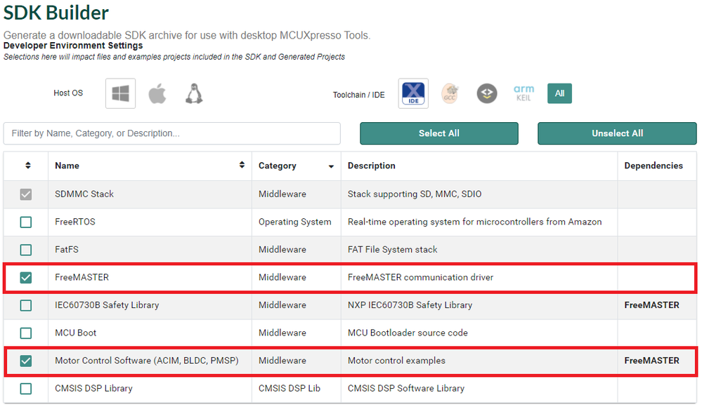

Hi @GaryOlmstead,
MCAT is part of the SDK and can imported from packaged "demo apps". So here are the steps (the first one is just there to validate you got everything in your SDK):
1. Generate SDK with Motor Control option selected (it will automatically select FreeMASTER as well)

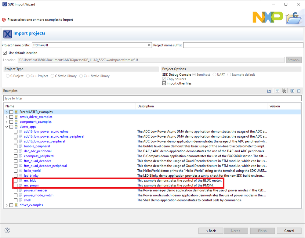

2. Once the SDK is added to MCUXpresso IDE, import the project from SDK examples
Capture4.PNGBLDC & PSM example projects can be found under "demo_apps" section

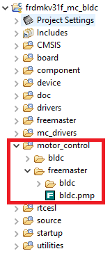

3. FreeMASTER project is located in motor_control → freemaster → bldc.pmp (or pmsm.pmp)

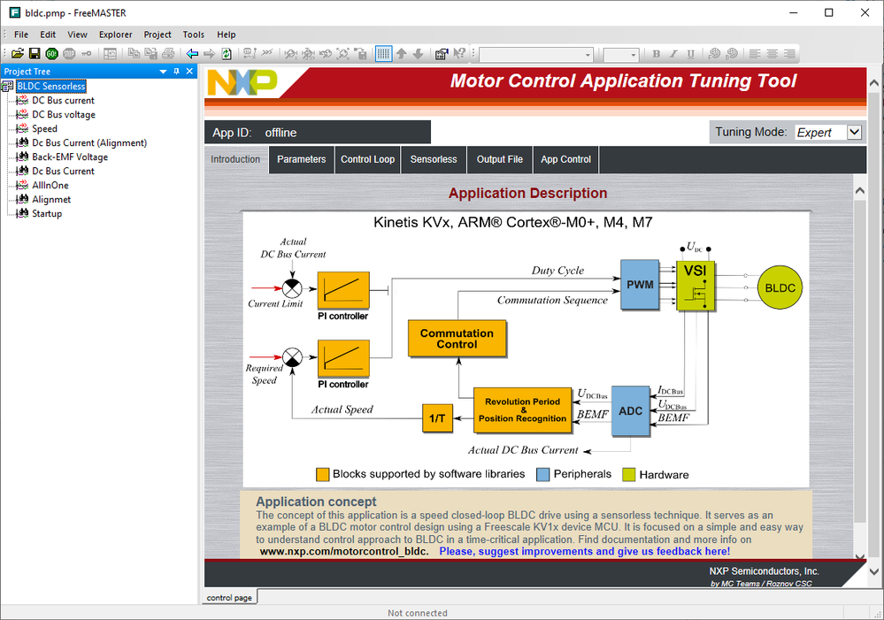

4. You can launch "pmp" file directly from project explorer which will open it in FreeMASTER tool.

Hi Iulian --
Got it!!  It works!!
Thanks!!
