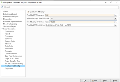

Stefan_9811
Hi stefanvlad,
thanks for your reply. Already solved the problem. My issue was, that i configured the wrong FreeMASTER stetup in the configuration block.
FYI you can find the correct configuration for my case attached.
Kind regards and thanks for your help,
Stefan

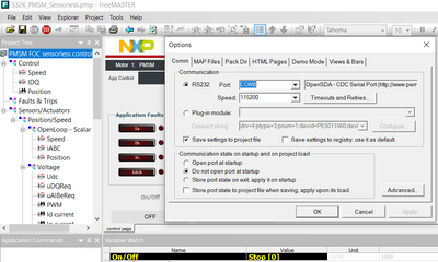

stefanvlad
Hi Stefan,
I will first recommend you install latest FreeMaster 3.2 from https://www.nxp.com/design/software/development-software/freemaster-run-time-debugging-tool:FREEMAST...
Then open the *.pmp project in FreeMaster 3.2 and then go to Project -> Options:
Here select your appropriate COM port and speed usually is 115200.
You should see COM port number for OpenSDA - CDC Serial in Windows Device manager:
After all this is sorted, click on the FreeMaster -> File -> Start Communication.
PS: before doing all of this, you need to open the model in Matlab and build it. this will create the needed variables for FreeMaster.
