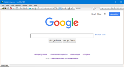

scotty
Hello @TomasK,
Thank you for your reply.
1) That is great. Most of the servers have changed from HTTP to HTTPS over the last few years for security reasons.
2) We would appreciate this feature. It would be helpful if relative paths were supported (for drives and URLs).

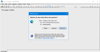

3) I double checked this with https://google.com. In this case the page is displayed within the FreeMASTER window. Maybe there is some property why there are two different ways how the page is displayed? (Inframe vs. external application)
This works as intended:
If the HTML page is retrieved from a file server, the following dialog is shown:
When I confirm the dialog, the page is opened in an external browser instance.
If the page is stored on a (network) drive, the page is opened in the FreeMASTER window as shown above.

TomasK
Hello @scotty,
could you please specify an example how the URL looks like when the page is opened in an external browser?
You mentioned file server, so is it file://... ?

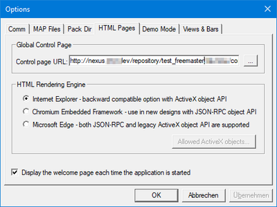

scotty
Good morning @TomasK,
the HTML page is fetched with http, as shown below.
The file contains plain HTML code, only one image is inserted.
Maybe the behavior depends on the MIME type which the server delivers?
I made another test:
I copied the path into the URL line of my Edge browser. The file is not displayed, but downloaded!
We use Nexus Repository OSS | Sonatype which is a file server but not a web server.
michaeL
