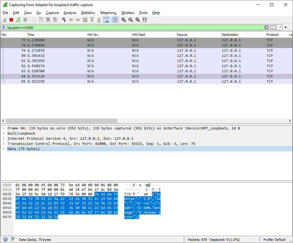

Is it possible to use a Wireshark to monitor the "Adapter for loopback traffic" and set a filter to tcp.port==41000? Then try to connect from a telnet console and type just empty curly brackets as two characters: {}
In my case, the FreeMASTER says:
{"jsonrpc":"2.0","id":"","error":{"code":-32600,"message":"Unknown error"}}
And the Wireshark logs 9 frames in total:
Michal
