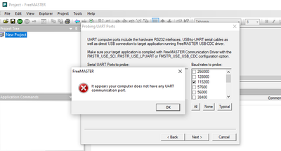

But I am getting the below error.
Could you please help to resolve this issue.

this kind of error is typical when you try to use an invalid COM port to connect to your target application. You can try to use a Connection Wizard by clicking at its icon in the main page or by using menu Tools/Connection Wizard.
Please describe your connection line between the PC and target application in more details.

I tried using connection wizard but the below error is showing.

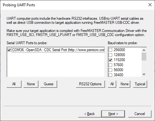

When properly connected, the FreeMASTER Connection Wizard should be able to find the OpenSDA COM port like in my case:

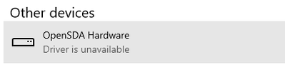

2). In device list, the OPEN SDA HARDWARE looks like below:
Do I need to install any driver software apart from FREEMASTER?

I think you are missing a OpenSDA driver for the virtual serial port (CDC) device implemented by the OpenSDA interface. Can you please double check the Device Manager in the Computer Management console (locate "This PC" icon on desktop, pull the context menu and select "Manage...")
You should see the OpenSDA-CDC and a COM number assigned to it (COM36 in my case shown in the picture).
If not, re-installing the pemicro drivers could help.
