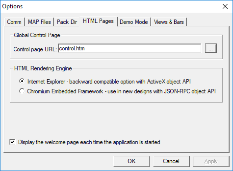

  I tried to use FM3.1 JS(ActiveX) to write or read FM variable to my local folder but fail. Can I print out the "FMSTR_PROJECT_PATH"? Any related example for local file handle?

The FMSTR_PROJECT_PATH represents path to a saved FreeMASTER project file (.pmp/.pmpx file).
Typically you will have your HTML page stored in the same directory as project file or (even better) in a subdirectory of a directory where the project file is stored. This will enable you to pack the HTML and all other resource files (pictures, script files, etc) to the .pmp file when saving (see User Guide section 5.3).
See a minimalistic test page code below. Save it as "control.htm" together with the project file and specify its name as the Control page URL in project options.
