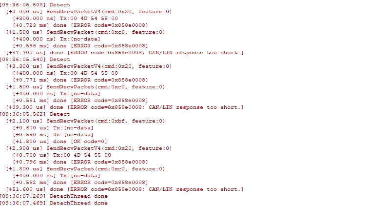

I found a problem in the CAN communication between uC s32k148 and freemaster.
In particular if I do Test Connection I get device alive then if I start the communication on the freemaster side with start communication I get the error response message too small.
On the uC side I respond to the communication with a message from FMSTR_STS_OK.
I think to understand that when I start the communication on the freemaster side he performs a configuration part and expects a specific response from the uC so I get this error. How do I understand which answer I have to give on the uC side to Freemaster so that I don't get the error message response too small?

the CAN communication plug-in reports error "CAN/LIN response too short" when the PC returns the CAN frame marked with the "Last"  flag before the full message (which consists of multiple CAN frames) is received.
Your "alive" test finishes well because it uses just a single CAN frame. Longer replies seem to fail in your case. I have seen this problem when MCU driver does not properly wait until one CAN transmission is finished and it starts to send another one too soon so it overwrites the unsent frame in outgoing buffer .. so effectively, it only sends the last one.

I tried to look through vector can analyzer.When I press the start communication button on freemaster I see several frames passing through the can that I think belong to the same message.
I report the sequence of frames and their content that freemaster sends: D1BB, 72C040, D1BB , 72C040,73BF0041, D1BB, 72C040.
on Side uC every time I receive a message I used the FMSTR_SendResponse configuring it in this way:
* pcm_pCommBuffer = FMSTR_STS_OK;
FMSTR_SendResponse (pcm_pCommBuffer, 1U);
I understand that as soon as I press start communication, freemaster sends a certain sequence of frames.
However, on the uC side, I simply configured the FMSTR_SendResponse with FMSTR_STS_OK.I think it is wrong to always answer FMSTR_STS_OK but how can I understand on the uC side which message to reply? I think it comes from this what that freemaster display error response too small.

Regarding your log: the first two commands FreeMASTER tool sends when you press the connect button is - try getting board information. The first one (0x20) is expected to fail because because it checks for a newer protocol version, hence the name "SendRecvPacketV4" (the response should be 0x32 0x82 0x73 that's what I get and is independent of the target). The next one (0xc0) should succeed (first byte of the response buffer should be 0x00 and total length 37 bytes) and return a valid message.
This would confirm that communication library works on the embedded side and  we can further investigate the communication between target and host.

There is, however, a problem that I just can't understand: I'm using short interrupt and uC side I can see the reception of the 72C040 frame.
This always uC-side frame prepares the response message on 37 bytes(36 + checksum) from FMSTR_Poll-->FMSTR_RxDone-->FMSTR_ProtocolDecoder-->FMSTR_SendResponse.
What is not clear to me is why only 3 frames are sent (being on 36 bytes should be 6 frames):I tried to put breakpoints and the first frame is sent passing through
FMSTR_SendResponse()-->FMSTR_ProcessCanTx()
second frame is sent passing through FMSTR_Isr() and FMSTR_ProcessCanTx()
third frame is sent by passing directly into FMSTR_TxCan.
The remaining 3 frames are not sent because I no longer end up in FMSTR_ProcessCanTx().
This seems to me to be very strange behavior and also I am using CAN analyzer to see frames passing through but I only see the message sent by FREEMASTER(72C040) but I don't see any uC side response. This I think is due to the fact that uC side are set in the various registers only the first 3 frames as a response on the 6 frames needed.
I didn't change the freemaster code I'm using FMSTR_Poll() and FMSTR_Init() and then I connected FMSTR_Isr() to CAN0.

michelet1
This is the error that appears on the Communication Debug Log when I press the Start Communication button. There are also 3 command codes that I think Freemaster sends as soon as the communication starts. Maybe Freemaster expects a precise response from the uC when it sends these messages?
