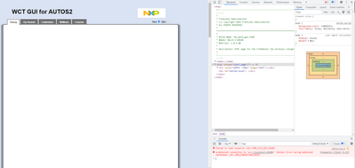

The FreeMASTER GUI does not work properly for the FreeMASTER 3.2 after a clean installation on a new laptop.

Hello Radek,
we have seen a few similar reports like this also in other FreeMASTER GUI projects. It seems there is a problem with FreeMASTER installer. It sometimes fails to acquire administrator rights before installation and the application executables are not properly registered. This causes the JavaScript in the GUI to fail creating the interface object.
You can try to fix the registration by running the "c:\NXP\FreeMASTER 3.2\FreeMASTER\register.bat" in the "as administrator" mode (see picture below).
The installer issue will be fixed in the next version. For your other installations (if any), it will be safer to start the installer manually "as administrator".
