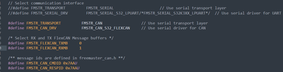

Currently, we want to use freemaster over CAN bus so that I need to change setting from LPUART to CAN. I already check the related post by other author. The following is my setting in freemaster_cfg.h file for now.
// Select communication interface
//#define FMSTR_TRANSPORT FMSTR_SERIAL // Use serial transport layer
//#define FMSTR_SERIAL_DRV FMSTR_SERIAL_S32_LPUART/*FMSTR_SERIAL_S32K3XX_LPUART*/ // Use serial driver for UART
#define FMSTR_TRANSPORT FMSTR_CAN // Use serial transport layer
#define FMSTR_CAN_DRV FMSTR_CAN_S32_FLEXCAN // Use serial driver for CAN
/* Select RX and TX FlexCAN Message buffers */
#define FMSTR_FLEXCAN_TXMB 2
#define FMSTR_FLEXCAN_RXMB 0
in main.c
/* Initializes FreeMASTER */
//FMSTR_SerialSetBaseAddress((FMSTR_ADDR)IP_LPUART_1_BASE);
FMSTR_CanSetBaseAddress((FMSTR_ADDR)IP_CAN_0_BASE);
FMSTR_Init();

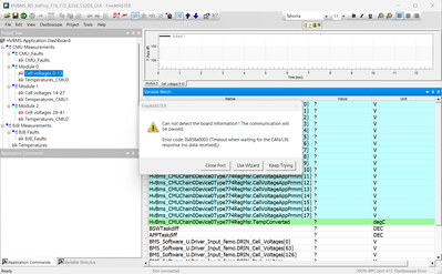

4. Freemaster can detect my board when I use S32DS to debug in the beginning but can't detect board after a while, the following is my test result
Can you help me to check if I miss any setting in side my project? Really need help, thanks.

2. No you don't need to define hardware objects for FreeMASTER explicitly. It will be done by FreeMASTER based on the configuration:
/** message buffers are defined in freemaster_cfg.h **/
#define FMSTR_FLEXCAN_TXMB    0
#define FMSTR_FLEXCAN_RXMB    1
/** message ids are defined in freemaster_can.h **/
#define FMSTR_CAN_CMDID 0x7AAU
#define FMSTR_CAN_RESPID 0x7AAU

4. There may be multiple causes for this one:
a) in polling mode - there is big delay in between FMSTR_Poll calls
b) in interrupt mode - there are other interrupts that take priority other FreeMASTER
This is much dependent on the application that is running along side FreeMASTER. You would need to find a proper tradeoff based on your application.
I would start by temporarily disabling the custom logic or allocating a higher priority to FreeMASTER to confirm whether it is indeed the case.

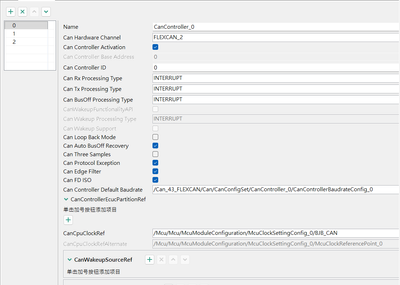

I use FlexCan_2 to implement, the following is my setting in freemaster_cfg.h file.
*The initial code inside main.c:
FMSTR_CanSetBaseAddress((FMSTR_ADDR)IP_CAN_2_BASE);
FMSTR_Init();
*The interrupt setting inside MCAL
I remove all canhardwareobject of flexcan2, only config cancotroller, and I didn't use flexcan2 in other task. But still can't connect freemaster. Do have any other idea?
BR, BillWen
3,239件の閲覧回数
iulian_stan
Hi @BillWen,
The first thing I noticed is that you configured FreeMASTER to use the first 2 message buffers (0,1) of CAN2, but interrupt handler is assigned to FlexCAN2_1_IRQn which corresponds to MB 32-63. Can you update it so FMSTR_CanIsr is executed.

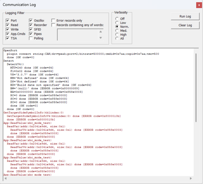

For the setting about interrupt setting, I change it to FlexCAN2_0_IRQn but "FMSTR_CanIsr" didn't execute. Original it will run if I set FlexCAN2_1_IRQn. (I already remove any can hardwareobject for flexcan2, I only set can controller)
1. The following is the freemaster log if connect successful, but it seems still wrong.
I also can get 0x7aa can ID by PCAN-VIEW
So I think freemaster sent tx successfully but s32k358 didn't reply or something, do you have any idea?
BR, BillWen
3,202件の閲覧回数
iulian_stan
You are right about the interrupt - I missed that the first (_0_IRQn) is triggered by buss off state.
The communication log shows that the requests return timeout error (0x858E0003) even in the detection phase. After you stop connection and try to connect again, does this behavior repeats:
- a few successful requests followed by timeout
or you need to reset the board to be able to get any successful messages from the board ?
