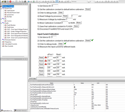

I have a board running an MWCT1000DS wireless power chip, and I'm trying to calibrate it using Freemaster V3.2 as described in the document "WCT1000 A11 Reference Design Calibration User’s Guide. WCT1000CALUG". When I get to input current calibration section and I click on the Read button to get the current reading, Freemaster displays the first reading and then it gives me an error symbol saying "board is not responding, timeout error: 2.1s" and keeps showing that error afterwards when I send any other command. The only way to fix it after that is to close Freemaster and launch it again.
Note that all other commands in the other tabs work fine up until I run the calibration.
Any help is appreciated.

The board is running fine and the coil is operational, and it does sense changes in the elf file. I was able to get around the error by clicking on refresh button which removes the error message, and I managed to calibrate the board.

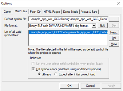

Freemaster project required to use same elf file which was upload into chip before. Do you see some request for reupload new ELF file after you change code in MWCT chip? If not please check if elf file which is use in project option is correct one.
If previous step is correct then i will double check if measure value is correct. From variable table we can see input voltage is show very low value which could during calibration break code and block other function.
