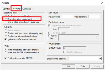

   I am new to FreeMaster,   I just learned using scope to observe data.  Now l want to know how to change the global variable's value  when doing parameter calibration ?

edit the Variable properties, and enable its modification on the "Modifying" tab (see picture). Then just add the variable into the Variable Watch and click the value cell in the text grid.
Refer to FreeMASTER User Guide for more details.
