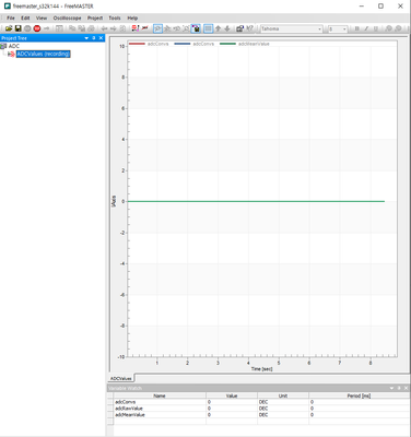

In example project 'freemaster_s32k144', i can see the data such as "adcRawValue" in S32DS.
But i cannot see those datas in FreeMaster tool.
Please refer to the picture and help me.
Thank you.

Hi @qiqu2771,
Could you check that your variable information was correctly parsed and imported into FreeMASTER. In Variable View (Project->Variables...->adcRawValue) "Variable Address" should show the same address as in DS (0x200004db in your case).
Another thing worth checking is the Log (Tools->Communication Debug Log...) for any communication errors.
