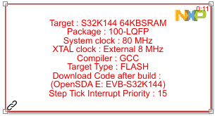

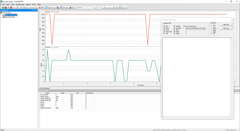

I'm looking to integrate LPTMR and FTM Timers into my own application, but they run into the same problems. The application is working but then times out or is overloaded in Freemaster. Oscilloscope shows that the board appears to be working fine, even after the timeout in Freemaster.
The issue is also present when using some of the MDT-Examples. Attached is the example "ftm_hall_sensor_tof_s32k14x.slx" I'm using.

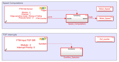

The issues appears to be the tof or the counter from the tof in the FTM-Triggered-Function. Models that don't have the tof or an input into / memory read within a FTM-Triggered-Function (or a LPTMR ISR Function) work without issue in Freemaster.
I changed the solver setting but it made no difference.
How can I resolve the issue?
Below some pictures to hopefully add a bit of clarity.

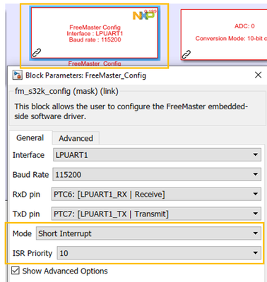

If anyone comes across this post, I found the solution for my model.
The issue was the setting from Freemaster.
The solution, at least for myself:
