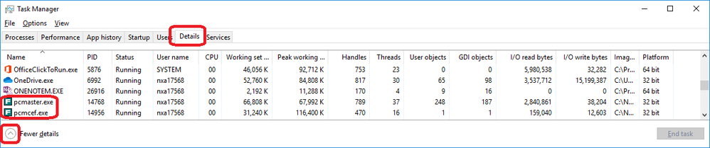

Also, when the issue happens and FreeMASTER vanishes from the screen, can you please do the following:
  • Run the Task Manager (Ctrl+Shift+Esc)
  • Expand "More Details" at the bottom
  • Select the "Details" tab
  • Sort alphabetically and check if the FreeMASTER processes still run - pcmaster.exe and pcmcef.exe in the list.
  • If yes, right-click the pcmaster.exe and select "End task"
  • Try to run FreeMASTER again.
