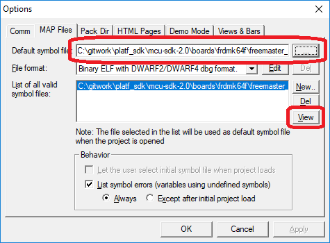

if the variable properties dialog does not show any resolved symbol address, the problem is most likely in the .out ELF file path or type. Please go again to the Project Options (Ctrl+T) to the "MAP Files" tab. The OUT file should be specified there and should be "Binary ELF ..." type.
To make sure the symbols are loaded correctly, press the "View" button. You should get a listing of all C symbols parsed from the ELF file.
If this does not help, it is also possible that your project uses a TSA runtime symbol tables embedded directly in the microcontroller application. Do you use the same application as in the first case which is working or have you created a new one?

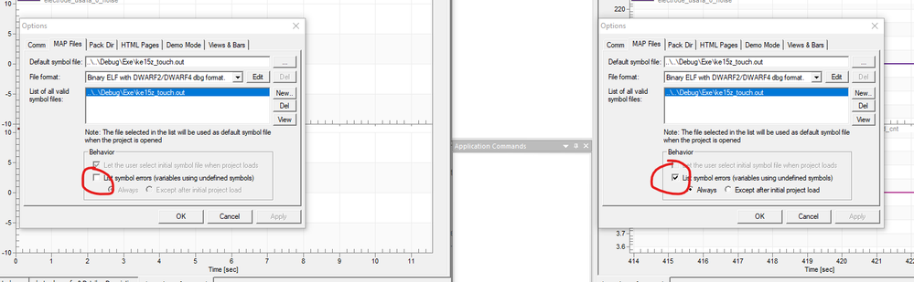

I am using the same *.out file in both FreeMASTER's projects (*.out file is generated by IAR and I think it is equivalent to *.elf file).
I also checked the "List of all Valid symbol files", and they both are the same for both FreeMASTER Projects.
Both the files are attached at the bottom.

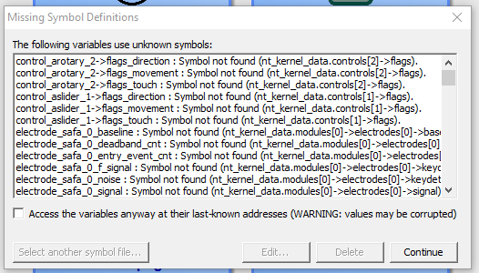

Apart from this, I am not using RS232/Serial and FreeMASTER drivers, I am using J-Link to plot this data on the oscilloscope view.
In the not working project at the startup, I get this error.
Here I clicked on the checkbox "Access the variables anyway at their last-known addresses"

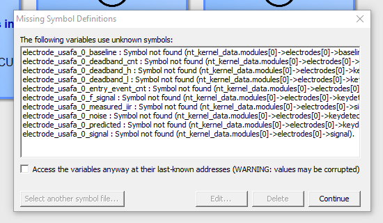

In the above update, I mentioned that when I opened the project (custom FreeMASTER project) I get the Missing Symbol Definition, which I didn't get in the FreeMASTER project which is working, I found the reason that this is warning is disabled with the FreeMASTER project provided with the NXP SDK, as shown below.
Left Side is Working Project (NXP SDK) and right side custom project.
And after checking this option, in the working project, I also get the same message in the project which is working, and even though it works fine.
