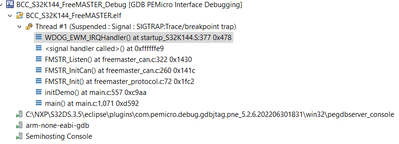

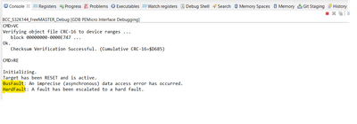

We are getting the following bus fault and hard fault when we are trying to execute the freemaster example application code for CAN communication. It fails exactly at these line in freemaster_can.c file.
/* configure CAN receiving (used by FlexCAN to setup MB) */
FMSTR_CAN_RINIT (FMSTR_CAN_CMDID_IDR0, FMSTR_CAN_CMDID_IDR1, \
 FMSTR_CAN_CMDID_IDR2, FMSTR_CAN_CMDID_IDR3);
Kindly help us on how to resolve this issue.

iulian_stan
Are you using processor expert to configure your board ?
If so, could you share your CAN configuration (pinMux, flexCAN) ?
That example is configured to work by default over UART. In order yo use CAN communication you would need to:
1. Configure CAN peripheral
2. Configure CAN pins
3. Call FLEXCAN_DRV_Init in the initDemo() function
4. Enable CAN interrupts (if you want to use FreeMASTER SHORT/LONG INTERRUPT mode)
5. Update freemaster_cfg.h to use CAN instead of UART
I commented the battery setup (I can not test a e2e scenario as I don't have a corresponding setup) and added the CAN configuration as per steps described above and was able to connect to the board from FreeMASTER GUI.
Note: by default SDK enables CAN abort mechanism, so I had to disable it manually:
/* Enter Freeze mode */
CAN0->MCR |= (CAN_MCR_FRZ_MASK | CAN_MCR_HALT_MASK);
CAN0->MCR &= ~CAN_MCR_MDIS_MASK;
while((CAN0->MCR & CAN_MCR_FRZACK_MASK ) == 0){}
/* Disable abort mechanism  MCR[AEN] = 0 */
CAN0->MCR &= ~CAN_MCR_AEN_MASK;
/* Enable the FlexCAN module */
CAN0->MCR &= ~(CAN_MCR_FRZ_MASK | CAN_MCR_HALT_MASK);
Hope it helps,
