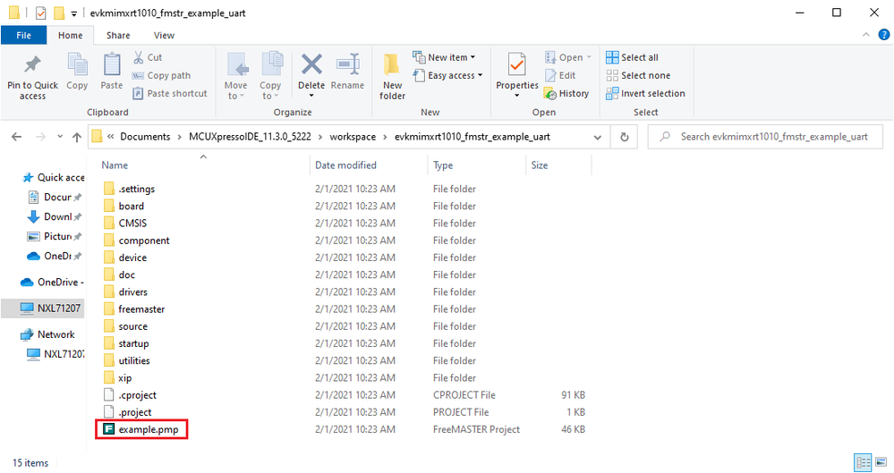

Using FreeMaster 3.1 with the RT1010EVK and MCUXpresso.  In my SDK, I have download the FreeMaster example uart application, and it runs on my RT1010EVK board.
In FreeMaster, I can connect to the board through the "Connection Wizard" with the simple serial port.  Now, what can I "do" in FreeMaster?  Is there an example tutorial that shows how to view/add the cariables in the firmware to FreeMaster?  Is there a ready-made FreeMaster project that I can load with this SDK example?

Hi @rt54321,
In the root folder of your project you will find a corresponding FreeMASTER project (`.pmp` file).
There is a basic example on FreeMASTER usage available in this article (video). A more extensive example about FreeMASTER features can be found here (webinar VOD).
