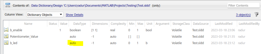

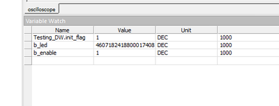

I am playing with the S32K146 evaluation board and with the freeMaster tool. I would like to know which would be the best practices when it comes to using Model-Based Desing in Simulink and saving variables as calibratable or signals via the Simulink Data Dictionary. (Using data store memory blocks is not an option for me)
Issue: One of my signals b_led is jumping from 0 to I guess an overflow...

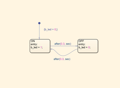

My Simulink model is quite simple for this test, I am using a chart for turning on and off an led.

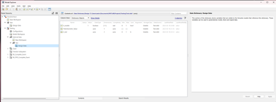

I have saved model data to an external data dictionary linked to my model.

1) Why is the value erratic?
2) What would be the best practice to save my Simulink Objects (Parameters/Signals/Lookup tables) in DDs.

I had a look over the screenshots you have attached to the post and my assumption is that there might be a mismatch between the data type of the b_led variable inside the FreeMASTER project and the actual variable data type from the generated code. I have made this assumption based on the fact that the DataType is set as "auto" and not a boolean or an unsigned integer type, and in most cases, the default data type associated would be "double". Please check this, or if possible, please share your little test model with me so that I could have a look directly at your model.

I can comment from the point of view of the generated code. Assuming that you want to use some variables stored inside an SLDD file, and you would want to avoid the Data Store Memories, you should consider using the StorageClass either Volatile (for sensible variables) or Generated Global. For both of the options, the variables will end up as global, and their name from the SLDD will also be visible as is in the generated code so that you could find them easily in the FreeMASTER. But Volatile will also tell the compiler that the content is sensitive and no optimization shall be applied.
