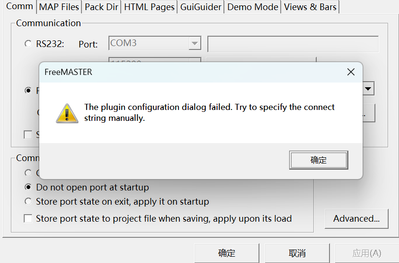

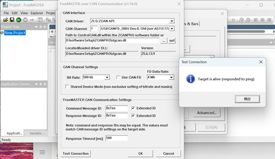

I was able to successfully conduct the CAN communication connection test in Figure 1, but after clicking OK, the fault as shown in Figure 2 occurred. How can I solve this problem?

we have identified the problem in FreeMASTER CAN plug-in and we are working on a fix. It appeared the plug-in has internally depended on Kvaser CAN driver and was not working correctly when Kvaser software was missing. It appears the Kvaser files are required even if using ZLG or any other CAN interface.
Before the fix is released in the upcoming FreeMASTER 3.2.7, a quick workaround is to install the latest Kvaser driver pack to your Windows system. You can download the Kvaser drivers here.
Thanks to all of you who had reported the issue and described the symptoms. Please reply to this message if installing the latest Kvaser drivers does not help to resolve the issue.

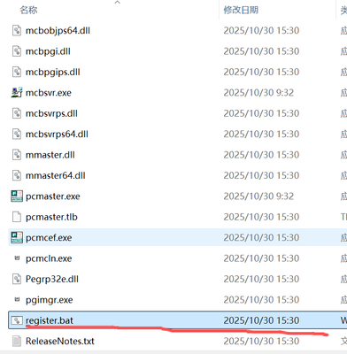

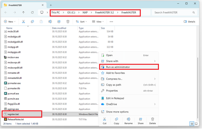

one thing to try is to re-register the CAN communication plug-in in your system. Please close the FreeMASTER, and navigate to installation location. Then run the register.bat "As administrator". See more details in one of the earlier posts in this forum.

zuozuo
Hello, according to the method shown in your picture, I am using the freemaster3.2 version of the host computer. I have tried on both a Windows 11 and a Windows 10 computer, but neither worked,

Hello the CAN plugin version 1.16.0 (in FreeMASTER 3.2.6.3) indeed adds the CAN-FD support for ZLG and some other vendors. It also adds support for the new ZLG ZCAN library. After  the registrer.bat has been run, we can be sure the plug-in is correctly registered in the system.
I cannot replicate the issues you are facing. The connection string for the ZCAN devices appears normally in my  case:  drv=ZCAN;port=1;bitrate=500000;cmdid=0x7aa;rspid=0x7aa;tmo=500
Please try the following:
  1. Paste the ZCAN string to the Options dialog manually and then open the plug-in configuration. Then close it without making any changes. Will it still show the error?
  2. Just as an experiment, try to enable the CAN-FD mode for the USBCANFD_200U device and press OK.
  3. Try to select another CAN driver, for example IXXAT, even if you do not have any physical device, then press OK.
Please let me know if it shows the error in all 3 cases.

Hello! 1. I manually added the information you provided to the command bar, then clicked "configure", and after entering, I clicked "ok", everything was normal. 2. Since I manually added the command information you provided correctly, everything has been normal. Whether I check or uncheck "canfd" is normal, even if I clear the command line, reconfigure it, and then click "ok", everything is still normal. 3. I use Kvaser, and everything is normal

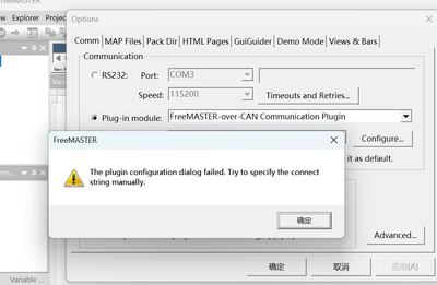

Thank you for your reply. I tested the above three steps, and each of them would report the error: "The plugin configuration dialog failed. Try to specify the connectstring manually". Additionally, I have run register.bat in administrator mode.
