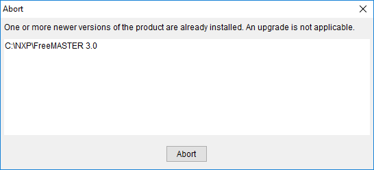

Fails to reinstall FreeMaster 3.0. What I did was to uninstall the FreeMaster and then try to install it again, which fails. The dialog says that there already is a product install, but there isn't any product installed. I have also removed the C:\NXP\ directory, but it still complains.
What can I do to solve this?

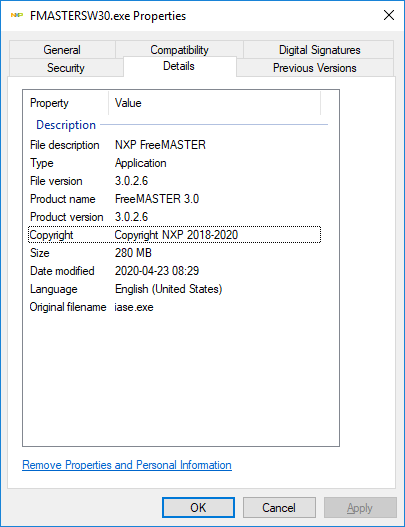

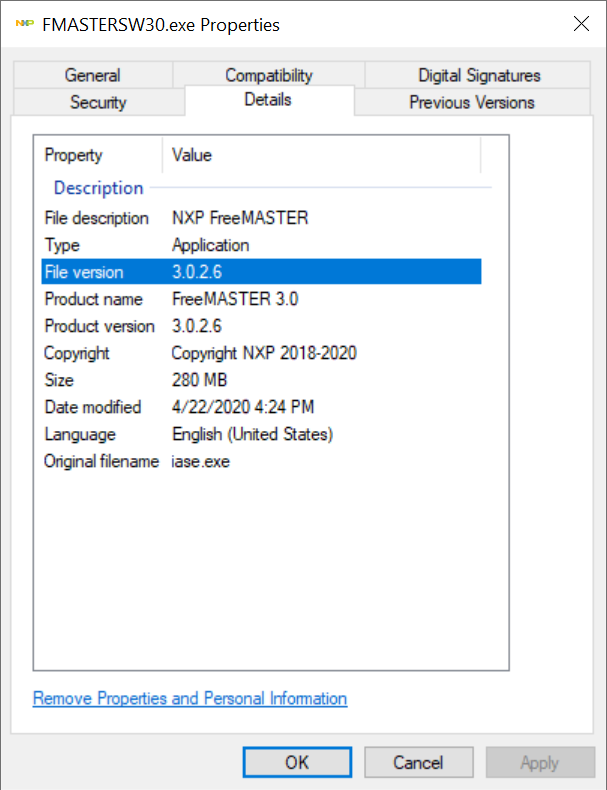

1. What version of the executable are you trying to install (latest one on NXP site is 3.0.2.6):
Capture2.PNG2. Is there any old FreeMASTER entries in "Program and Features" window ? If yes - what version ?

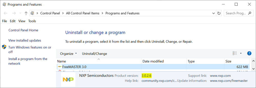

niclas_karlsson
I tried to rename the installer exe if that is what you meant. Didn't work.
This is the screenshot from the installer details:
No entry for FreeMaster in the "Uninstall or change program".
And I couldn't find the key in the windows register.

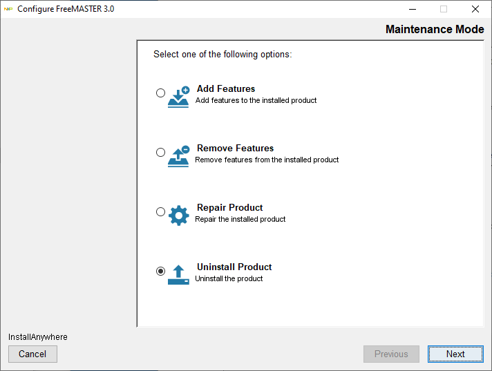

  1. Install same version of FreeMASTER on another PC (if not already installed)
  2. Copy the following two folders from the installation directory to your PC _FreeMASTER_installation and jre.
  3. Run Uninstall FreeMASTER.exe from the copied _FreeMASTER_installation folder
    If it succeeds you should be able to see the following window
  4. Uninstall Product (it did a proper cleanup in my case and I was able launch the installer after)
If that does may need to wait for another release of 3.0 to avoid making Windows Restore as per Tony's comment.

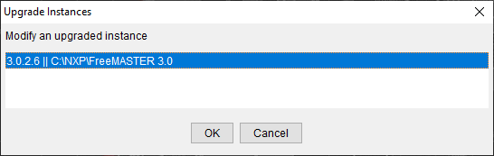

Component selection should've not affected the system in such a way, because from installer's point of view there's only one application called "FreeMASTER 3.0" which contains 2 sub components: "FreeMASTER" - desktop application, and "FreeMASTER Lite" - service. If it where to identify an already existing component you'd be prompted with the following screen.
Capture2.PNGWhich would allow you to manage sub-components.
This behavior (including the one you are facing) is based on the information stored in com.zerog.registry.xml (according to the packager we are using). I'm currently checking whether there may be other verification mechanisms or non default file location.
