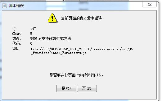

Open Freemaster 2.5's Motor Control Application Tuning Tool, and when I set the Tuning Mode to Basic, an error prompt as shown in Figure 1 will occur. I'm in the parameters TAB How to solve this problem?

After Upgrading Internet Explorer to the latest version and fixing the system, FreeMaster was fine.

Hi [email protected]‌,
There are some known issues with MCAT tool in the older version of MCUXpresso SDK. What version are you using ? The latest one is (v2.8). It is also recommended to use the latest version of the FreeMASTER tool (v3.0).
Could you please upgrade to the latest version of both tools, and let us know if you are facing the same issue.

Dear Iulian
I'm using FreeMASTER 3.0, and I'm opening bldc_ref_sol.pmp in MCRSP_BLDC_V1.3.0,The same problem still arises

Hi .[email protected]‌,
Do you get the same error after in the SDK example as well ?

 Dear Iulian
Yes, the same error still appears.

it seems that the Internet Explorer rights are restricted on your computer so the JavaScript cannot access all objects in the control page.
Can you please try to enable Scripting and IE Active content in the Internet Explorer options? Please see the discussion in this community thread.

I have tried as prompted, but the same problem still exists, and it only appears in the parameters TAB
