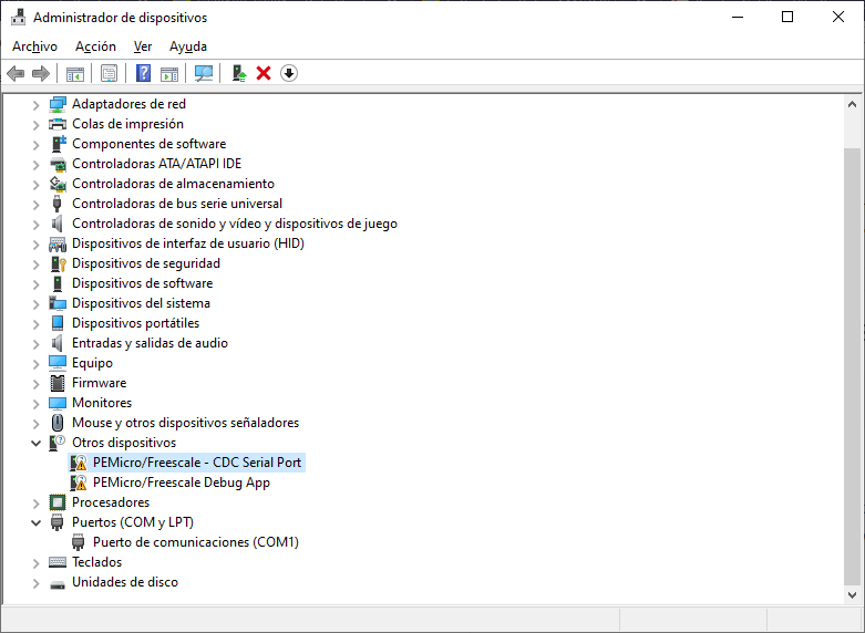

Hello everyone,
I'm currently trying to connect the platform s32k148 with Freemaster with no luck. I have installed FreeMASTER Communication Driver and Freemaster 3.0. However, when I try to connect to the platform using the connection wizard in FreeMASTER I'm not sure how to configure the connection. Moreover, in the Device Administrator I can see that there is some issue with the drivers. If I understand correctly, the platform should be linked to some COM port, so when I download the code after build I use the same COM port (I have been using the OpenSDA interface for downloading the code to the platform).
Any help or links to guide me in the process is much appreciated. Thanks!

Hi Fermin,
From what I see you need to sort out the connectivity issue first (which at this point is not FreeMASTER related).
First things I would suggest to check:
It is indeed as you guessed - when the target is properly connected you should be able to see on OpenSDA entry in the COM ports list. Another drivers check - you should be able to see an additionally mounted memory device in "My Computer" (it's usually called EVB-S32K148).
Once you sort it out you can try connecting to the board, for this you can check the following video (starting at min 1:15).
