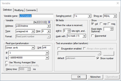

Dear Michal, FreeMASTER developers and power users,
I use a recorder to monitor the Unix time which is right now around 1684321580. These are ten digits.
Though the variable is an integer value, the scaling shows a decimal fraction with the suffix B (assumingly for "billion" = 10^9).
Is it possible to change the numeric format?
It would be nice to see all digits, preferably with some decimal separators, for example 1,684,321,580 (if the American style is used).

Hello Michael,
the way the graphing component renders the Y axis is not easy to change.
I would recommend to post process the variable using linear transformation for example: (a=1, b=-1682892000) so you would rebase your Unix timestamp to May 1st 2023. This way the numeric values would be within a better range and should display better in graphs.
Michal

scotty
It works:
Here, I used an offset which is related to Thu May 25 2023 18:40:00 GMT+0000.
