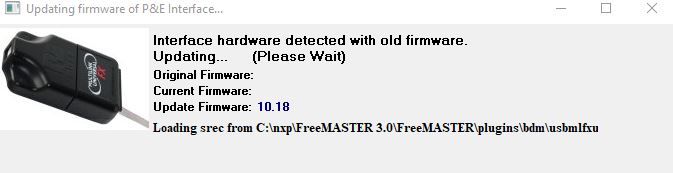

If have encountered the following:
I update Multilink firmware with PEFirmwareConfig tool to usbmlfxufjtagens.1018 (should be latest version).
If I connect to freemaster and test the connection to the targed the firmware is automatically updated from version 10.18 to 10.36.
But at the end of the update process 10.18 is shown as the new version.
I could not find a difference in firmware images comming from P&E update tool and the ones provided with freemaster installation. Why is the update started? Could there be somthing wrong with the firmware update? Can you see the same at your side?

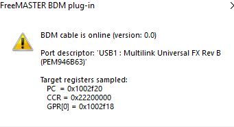

The connection test shows this result:
Is BDM version 0.0 correct?
Jörg

Hello Jörg,
when testing on our side, Lukas also sees BDM version 0.0, so I believe this is correct. The set of P&E firmware files included in FreeMASTER 3.0.2 has been provided by our partners in P&E directly, so I believe it is correct too.
The reason why you see intermediate update to 10.36 is most likely the update of Multilink bootloader (usbmlfxufbootens), later followed by update to Qoriva/PX firmware usbmlfsufjagens to version 10.18.
Just to be sure, you may use the official P&E updater (PEFirmwareConfig.exe) and remove all firmware images from c:\NXP\FreeMASTER 3.0\FreeMASTER\plugins\bdm to prevent any further update. But I do not think this is going to help.
