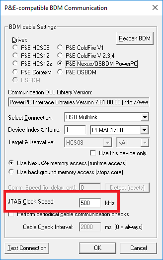

Dear Jörg,
I have enabled the JTAG clock speed to be specified when Nexus2+ mode is selected. Please extract the plugin DLL from attached ZIP and replace the existing file in c:\NXP\FreeMASTER 3.0\FreeMASTER\plugins\bdm. The JTAG Clock Speed field should be editable in the new version. Specify value in kHz, it will be internally re-calculated to a divider value N in range 0..31 supported by P&E interfaces (Multilink, Cyclone and Lightning only)
For USB Multilink, the calculation is (the formula is different for Cyclone and Lightning):
   N = (1000 / Clock_kHz) - 1
   Clock_kHz = 1000 / (N+1)
In the old plugin version, the N was set to 2 for USB Multilink. So the JTAG clock was fixed at 333 kHz. I'm really curious if setting a lower values will help in your case.
Michal
5,709 Views
jobu
Dear Michal,
unfortunately also this doesn't help.
So now I'm out of ideas for further investigations. I will buy a new board and give it a try. I let you know about the results, but this can take a while. Nevertheless thank you very much for your support...
Jörg
