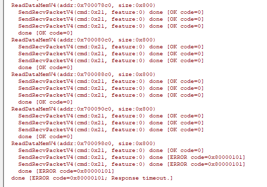

I don't know what was the issue with my setup, but I can confirm that there is no tool limitation in handling a 2MB recorder buffer. I can now download the complete SDRAM. I achieved this with UART communication at 2.56 Mbps in 3'40'' download time.
Then I went further and I tried UDP communication to hopefully cut down that transfer time. In general the communication works, but I do see issues when attempting to download my large recorder buffer.I am getting a lot of "Response timeout" errors when I try to download anything larger than 40 Kb.
To investigate this issue, I inserted test pins in the freemaster driver code, before/after the invocation of _FMSTR_ReadMem (track 0, black) and _FMSTR_ReadMemBaseAddress (track 1, brown)  in freemaster_protocol.c.
And I noticed that _FMSTR_ReadMem is the one mostly used to access my SDRAM. There are bursts of invocations every 5ms (the rate at which I call FMSTR_Poll) separated by long idle intervals. Which may be the problem? I also had a look at the communication log which reports the occurrence of timeouts.

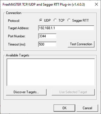

I tried to play with the FMSTR_COMM_BUFFER_SIZE define (make it larger or smaller) and the Timeout parameter of the UDP/TCP communication plugin (which seems to influence the duration of those idle times displayed in the logic analyzer trace posted above):
But no ultimate solution. Any idea?

Hello Luca,
thanks for the report. Let me investigate what could be wrong with the UDP. This communication should be quite reliable on the wired Ethernet without packet losses (which I think causes the timeout and delays). But still a few timeouts should not break the whole transfer.
Let mi investigate on my side. In the meanwhile, is it possible for you to:
  • decrease the FMSTR_COMM_BUFFER_SIZE to 508
  • try TCP transfer
Michal

Hi Michal,
TCP seems to work. I will check more thoroughly but from a quick attempt it looks good. I agree with you that there shouldn't be packet losses in a wired host-target ethernet connection. But apparently there are (at least in my setup) and likely it is the connection orientation of TCP that fixes this with re-transmissions.
These re-transmissions are probably slowing down the recorder buffer transfer, which could be faster otherwise. But it is already an achievement. Thanks for advising.

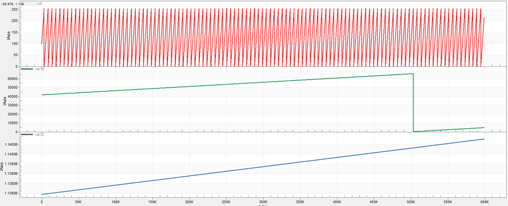

Dear Luca,
I cannot repeat the issue on my side. I have tried an i.MX-RT1060 UDP and TCP demo applications from SDK 2.11, modified to run from external SDRAM and with a recorder buffer of 2M. The example recorder which samples var8, var16 and var32 variables seems to operate correctly, loading approximately 600.000 points.
As all test variables constantly increment so I think it would reveal the issue of "split download" as you have described. The waveforms look correct: var8 overflows above 255 and var16 overflows above 65535 just once. The var32 seems linear - which kind-of proves the recorder was fully stopped during the whole download.
What is the setup on your side? What MCU, what communication?
Can you try to repeat the issue with a simple example application?
Michal
