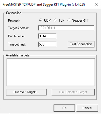

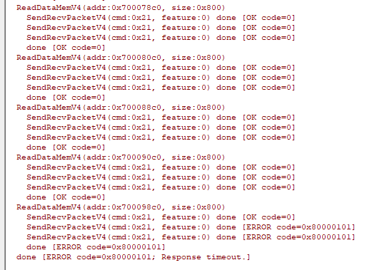

Then I went further and I tried UDP communication to hopefully cut down that transfer time. In general the communication works, but I do see issues when attempting to download my large recorder buffer.I am getting a lot of "Response timeout" errors when I try to download anything larger than 40 Kb.
To investigate this issue, I inserted test pins in the freemaster driver code, before/after the invocation of _FMSTR_ReadMem (track 0, black) and _FMSTR_ReadMemBaseAddress (track 1, brown)  in freemaster_protocol.c.
And I noticed that _FMSTR_ReadMem is the one mostly used to access my SDRAM. There are bursts of invocations every 5ms (the rate at which I call FMSTR_Poll) separated by long idle intervals. Which may be the problem? I also had a look at the communication log which reports the occurrence of timeouts.
I tried to play with the FMSTR_COMM_BUFFER_SIZE define (make it larger or smaller) and the Timeout parameter of the UDP/TCP communication plugin (which seems to influence the duration of those idle times displayed in the logic analyzer trace posted above):
But no ultimate solution. Any idea?

thanks for the report. Let me investigate what could be wrong with the UDP. This communication should be quite reliable on the wired Ethernet without packet losses (which I think causes the timeout and delays). But still a few timeouts should not break the whole transfer.
Let mi investigate on my side. In the meanwhile, is it possible for you to:
  • decrease the FMSTR_COMM_BUFFER_SIZE to 508
  • try TCP transfer
Michal

TCP seems to work. I will check more thoroughly but from a quick attempt it looks good. I agree with you that there shouldn't be packet losses in a wired host-target ethernet connection. But apparently there are (at least in my setup) and likely it is the connection orientation of TCP that fixes this with re-transmissions.
These re-transmissions are probably slowing down the recorder buffer transfer, which could be faster otherwise. But it is already an achievement. Thanks for advising.

good to hear the TCP works better. I did a quick re-test with UDP and even larger 8MB recorder buffer and it downloads reliably over my local network (I use i.MX-RT1064). For UDP, it takes about 20 seconds, for TCP, the same buffer takes about 30 seconds.
FreeMASTER protocol was not really designed for large data transfers. The PC tool should retry up to 10% of lost (timeout) frames when loading a large memory blocks, but even this does not seem enough in your setup. The TCP is a good solution here as it ensures the retries and delivery by itself.
