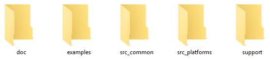

Self-extracting installation package is available on FreeMASTER download page under BSPs and Device Drivers section. After installation it will create a folder (default path - C:\NXP\FreeMASTER_Serial_Communication_Driver_V2.0) on your system with the following content:

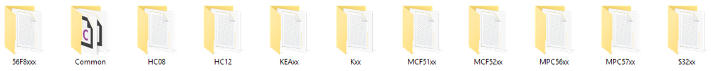

You can start with ready to use projects from examples\SCI_driver_examples folder:
Each example contains a readme file specifying environment requirements (target board and used IDE). To start a new project you would require to add just two folders to your project src_common containing generic protocol implementation and platform specific sources from src_platform. The latter has a similar layout to the examples (with a per platform sub-folder).

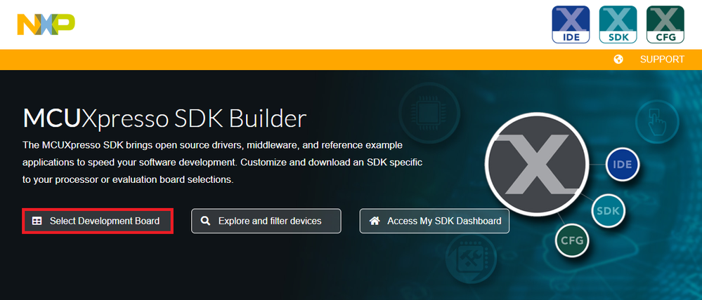

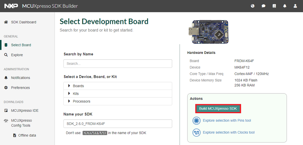

Navigate to Development Board Selection, choose a Board/Kit/Processor and build the SDK.

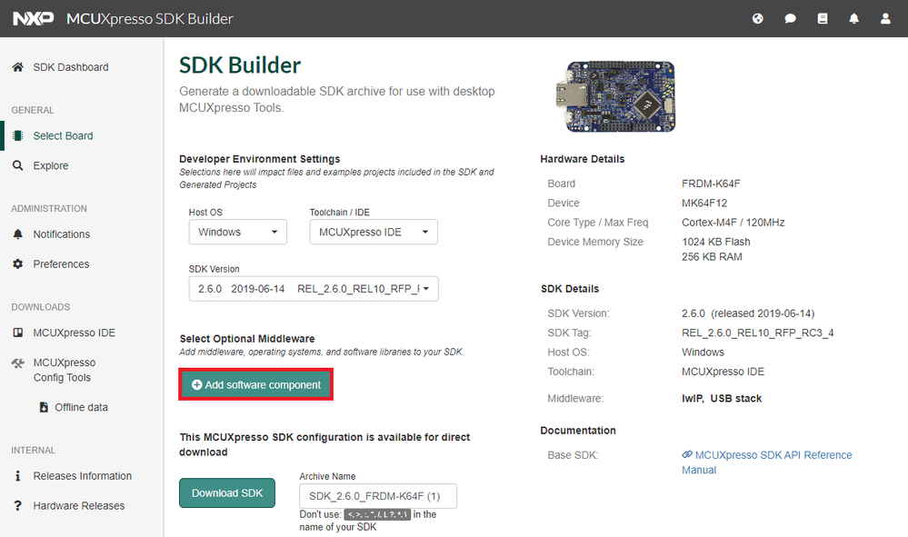

Once the build is ready make sure that FreeMASTER Component is included.

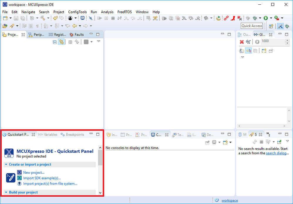

Save your changes and download the SDK. You can import the it from MCUXpresso IDE QuickStart Panel :
In case it is not visible you can add it to your view from: Window → Show View → Quickstart Panel.
