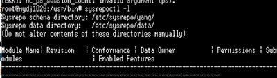

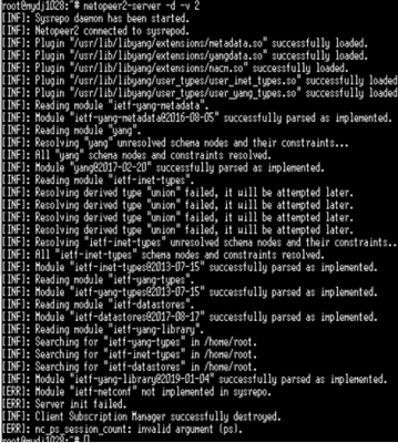

Here I use yocto version other than openil.  I checked the  /etc/init.d/S91netoper2-server file and found out it sure running after reboot. But I still not sure wether it running successfully or not. So I tried to  manually execute the netopeer-server at path /usr/bin/netopeer2-server. Here is the log down below.
you can see there are some ERRs.
I think it might beacuse of losing some modules. Then i tried sysrepoctl -l
It seems no modules were loaded?
It might be the kernal problems for yocto version? Can you show me the log on your board after do  sysrepoctl -l and netopeer2-server command?

Indeed, according to your logs after running sysrepoctl -l,  I can see that no YANG modules are installed in sysrepo... What do you have on /etc/sysrepo/yang/ and /etc/sysrepo/data/ ? In my case, I have lot of .yang files in /etc/sysrepo/yang/
Here is my logs after running netopeer2-server -d -v 2 (watch the attached files in the following order A1, A2, A3).

Thank you so much my friend. I think you are right that my Yocto version isn't configured well.
Indeed, my logs shows that no YANG modules are installed in sysrepo. So I tried to install it manually since I was not to able to change the kernel.
After installed all .yang files I got the logs after running netopeer2-server -d -v2 and  sysrepoctl -l .
You can see the logs after running sysrepoctl -l ( attached file B1)are same as yours but for netopeer2-server -d -v2 ( attached file A1 A2 A3) are different.
It seems that the server is not able to listen to 0.0.0.0 port 830 ? Do you have any ideas that why permission denied and how do I fix it?
Another question, I check your logs that there are still some errors like "Module "ietf-yang-library@2018-01-17" in another revision "2019-01-04" already implemented". Is this error doesn't affect the netopeer2-server?

I think the key point of the error is the kernel version that I used to run yocto 2.0 on my board.
After that , I asked my colleague to build 2.2 version and it was fixed.
Now, on my board the netopeer-server can run well and it still listen to (0,0,0,0) IP adress. But this time it can bind it without permission denied.
