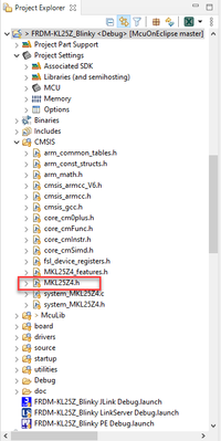

I just started reading and working through the book "Embedded Systems Fundamentals with Arm Cortex-M based Microcontrollers" by Alexander G. Dean. The author requires that the reader includes the header file MKL25Z4.h but does not gives any instructions on where to get it. Does anyone in here has some info that can help? Thank you very much.

if you create a project with the NXP MCUXpresso IDE and the SDK, you will find that file inside the CMSIS folder:
You can find that file (and project) on my Github repository too:
https://github.com/ErichStyger/mcuoneclipse/tree/master/Examples/MCUXpresso/FRDM-KL25Z/FRDM-KL25Z_Bl...
I hope this helps,
Erich
