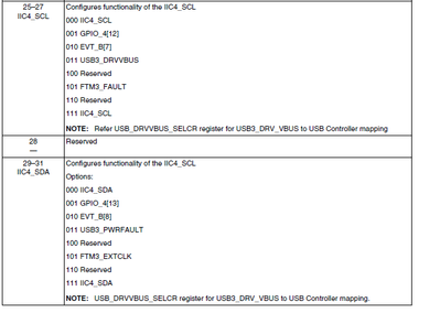

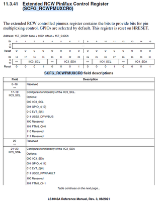

I checked the datasheet
from the datasheet,it says the default value is 0000_1111h.
I add the bellow command to rcw_1800_qspiboot_1133_5a59.rcw
.pbi
//SCFG_RCWPMUXCR0, configure IIC4_SCL/SDA=000
write 0x157040C, 0x00000000
.end
after I add above command, the device cannot boot up.
I tried 0x00000011, 0x00330000.
all values will cause the device cannot boot.
What value do i need to configure? or I need to do more configure for this function?
