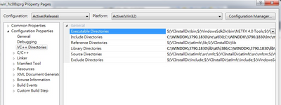

Hi, Team,
Customer would like to modify the scenario of the Master side GUI in AN2295SW. Checked the source code, it's feasible but met the problem of compiling the source.
Here is the progress:
Unable to use VC++ 2008, it shows newer version is required.
 In VC++2010, it shows "afxwin.h no such file in stdafx.h"  when compiling.
The similar problem has been met in another thread previously, but without answer.
Cannot build AN2295 bootloader Master P.C code - NXP Community
Installed DDK 3790.1830 -> include Directories add
C:\WINDDK\3790.1803\inc\atl30
C:\WINDDK\3790.1803\inc\mfc42
Library Directories add
C:\WINDDK\3790.1803\lib\atl30\i386
C:\WINDDK\3790.1803\lib\mfc4\i386
stdafx.cpp can pass but still with errors. Looks like incorrect DDK version is used.
Could you please help advise what kind of combination is sufficient to build the MASTER side source? Thank you.
Update the finding:
We found the errors are from the lack of related *.rc files for the definition of GUI icons and its headers.
So the problem may be to find out the "complete" project for the MASTER side.
I attached the source I got for your reference. But I have no idea where it came from by long history and handled by other members.
Thank you.
