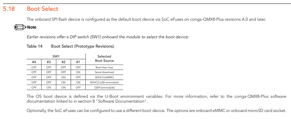

From the User Guide:
So the conga-qmx8-plus boots from SPI flash by default and to boot from another source, you must modify the SoC eFuses. If you go to the Wiki for the yocto project you will see this in section 4: "With the above created system image the system boots from SD-Card. It is possible to boot from QSPI if the bootcontainer is flashed inside first SPI partition." This is perhaps slightly misleading or incorrect. Was "possible to boot from QSPI" written when DIP switches were a thing on early revs of the SOM so you had the option? Or is it saying, if you wipe the first SPI partition that it won't try to use that bootloader? (Doubt it). Anyway, this is probably all the same deal for the SMX8-PLUS SMARC. In that case, the bootloader is loaded from SPI flash. You must edit the board header file (where the environment is setup), the device tree to make sure the console will be set to the correct uart, and it looks like update the defconfig to not boot from SPI flash as well. Build the project, flash it to the SPI flash, and hope it works. I'm assuming you need the congatec dev board to work through this because if you brick u-boot using the on SOM runtime flash procedure, you won't be able to fix it.
