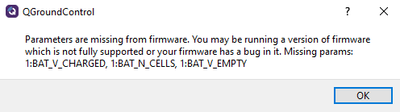

After installing the bootloader and firmware recommended by gitbook, i have been unable to proceed through the QGroundControl app. It states that the Firmware is not supported or has a bug. i have repeatedly tried to reinstalled the bootloader and firmware but still comes out the same. Is there a way to get through this problem?

Please give is a try with just flashing the bootloader via the Segger programming Tool. My guess is that you are programming PX4 FW over the bootloader. PX4 FW needs to be programmed starting at adress 6000.
Therefore the easiest way is to just program the bootloader via the segger Tool. Reboot the FMU afterwards (Power cycle).
Only after that connect it to your PC having QGC at the FW Flash page.
