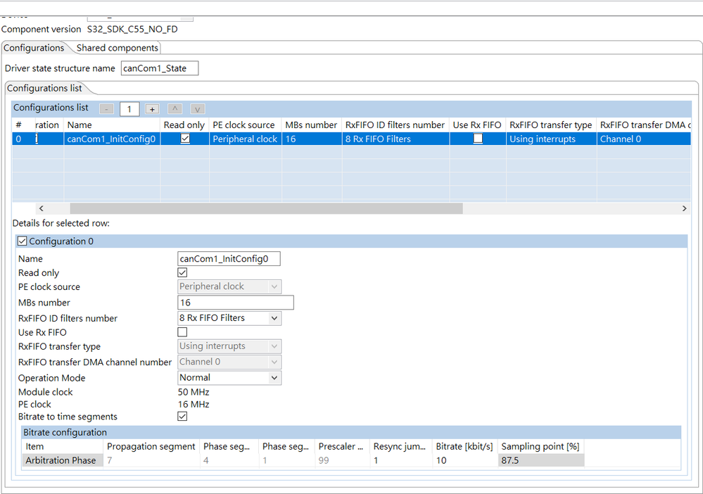

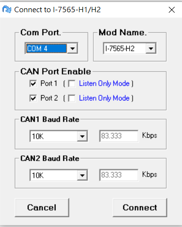

Also you set bitrate to 10kbps in flexcan components. This is quite low one. How this can work as EVB is using TJA1041 which has minimum possible bitrate of 40kbps (due to TXD dominant clamping detection)?
Moreover the CAN bit setting of the PC tool is weird, 10K is selected and it shows 83.333 kbps.
So do you have really same bitrate set on MCU and PC side? The same sample point is also recommended.
BR, Petr

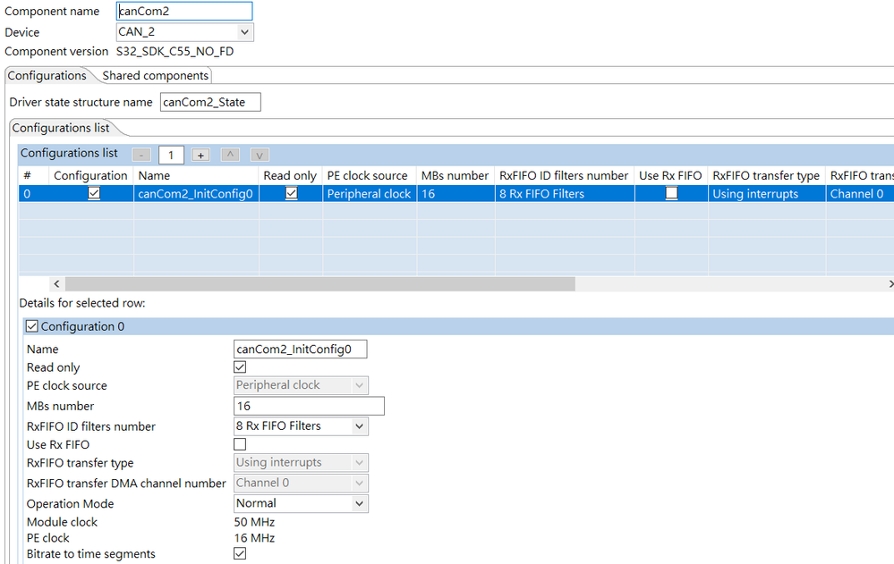

do you use EVB on your side? Seems you are using 2 FlexCAN modules, do you want to do communication between those 2? If yes, how those modules are connected together?
Regarding a code; it is not needed to call FLEXCAN_DRV_ConfigTxMb() each time you want to send message. You have placed this in main's while loop. Also calling non-blocking FLEXCAN_DRV_Send() periodically is not correct. You have to be sure previous transmission is finished. FLEXCAN_DRV_GetTransferStatus() can be used for this.

dreamtea81125
This is my setting in can converter. Thank you.
